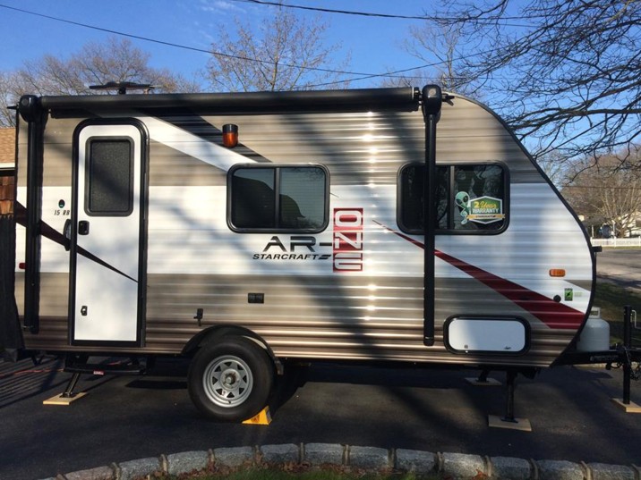

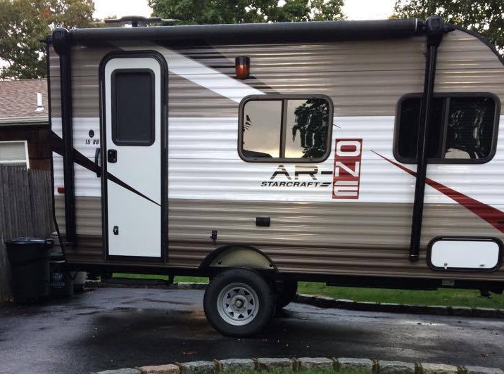

Sorry for the late reply . without seeing it , It would be a rather uneducated guess at best ! . I think Most Larger trailers are built naturally higher to allow a better approach / departure angle . A combination of larger frame rails , spring mounts , longer shackles . I have only one other guess . I had a small travel trailer that came with a Drop Spindle axle , mounted above the springs and sat at what I would say regular height . To achieve a lift , I had it replaced with a straight axle , and left that mounted above the springs . The elimination of the spindle drop , achieved the lift . Here's the additional uneducated guess . without knowing the regular model ( not extreme package ) , maybe it comes with a drop spindle axle and sits lower ? or they all sit the same ? Best of luck , sorry I couldn't be more helpful :(

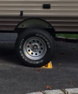

Ok , I am sure there is little to no interest , but if anyone cares , the rims I used for the upgrade from 14s were 15 x 6 , with the bolt circle / pattern of 5 x 4.5 . I am using Cooper AT/3 tires , 235 / 75 x 15 , load range C . I also replaced the original step with a 2 step unit , and I extended the 2 front Jacks and added a drop foot to the tongue jack , for the added height .

Late post again as usual , if anyone still cares , but one of the main after season things to get done . The axle flip (as it's called ) actually axle moved under springs . Also plan on larger Rim / Tire combination
This should save my back from the digging a grave for the portable waste each time :lol:
