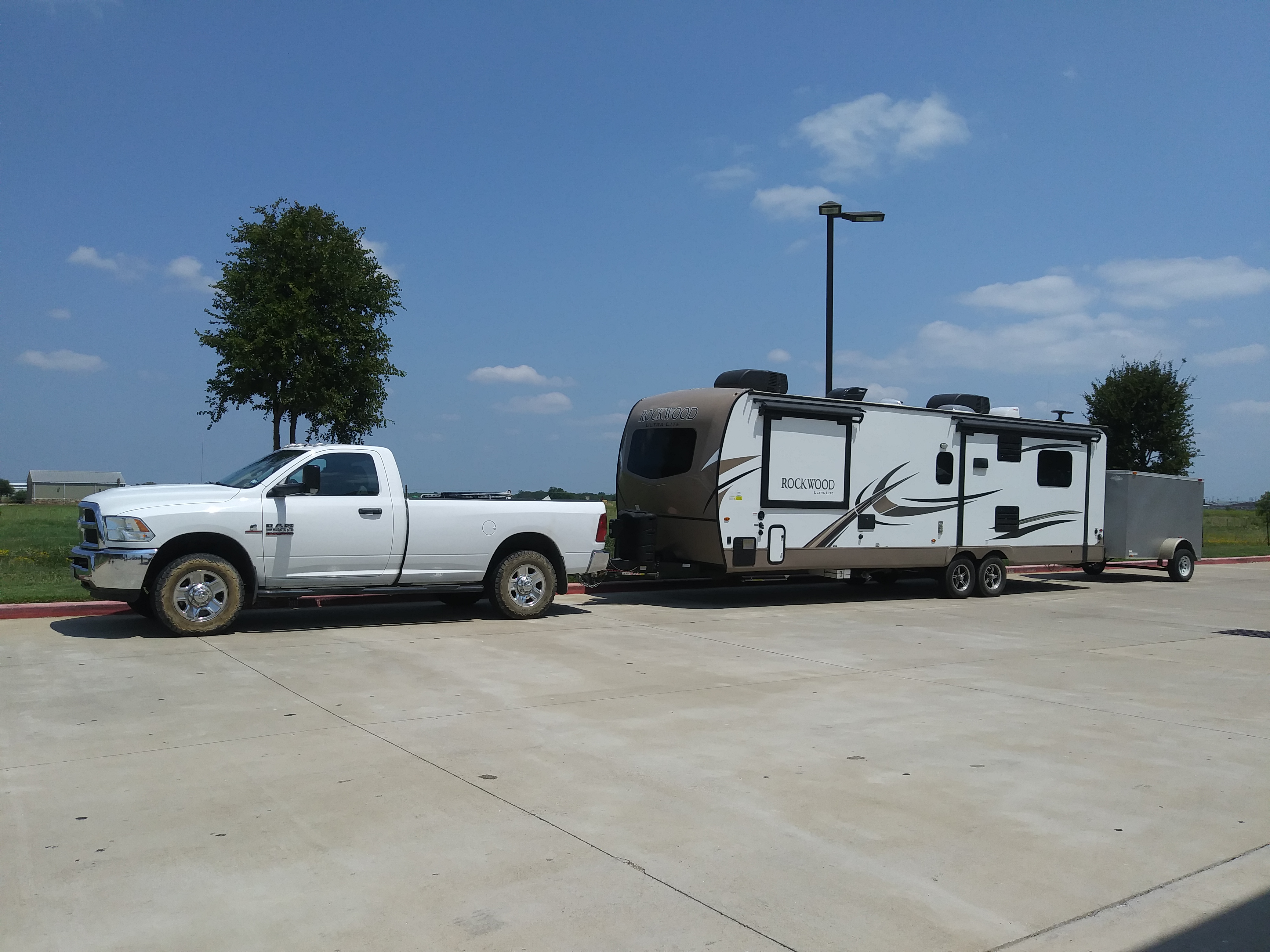

Adding a hitch to the rear of my trailer
Re: Adding a hitch to the rear of my trailer
Towed130 miles with zero problems
Technically, your towing illiegal. The first trailer must be a 5th wheel trailer. I doubt you'll ever get stopped for it or have any issues.
- 0824181251b.jpg (3.86 MiB) Viewed 17119 times
2015 24 RLS with some mods
2014 Ram 2500 diesel
I towed double with my 5'er. The laws in Tx says the first trailer has to have a 5th wheel hitch and have brakes. Most trailers are not built with frames that allow the weight and forces of another trailer hooked to them. It's usually bigger 5'ers where you start finding this. You can do it. I doubt that you'd get stopped. I doubt that you'd find a welding shop willing to add a hitch and extra beef for in on your frame. if you have any warranty, you'll void it by welding to the frame. If it looks unsafe it probably is and you'll probably get stopped. It would need to be done where you don't draw alot of attention to it. Length laws changed a couple of years ago. There are several that overlap and can be controversial. If you get stopped it will come down to who is stopping you and what they thing about what you have setup.
