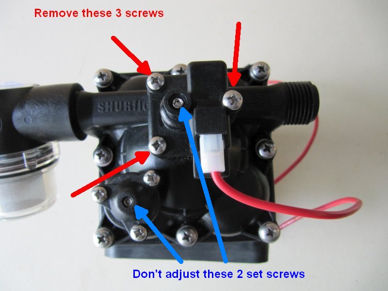

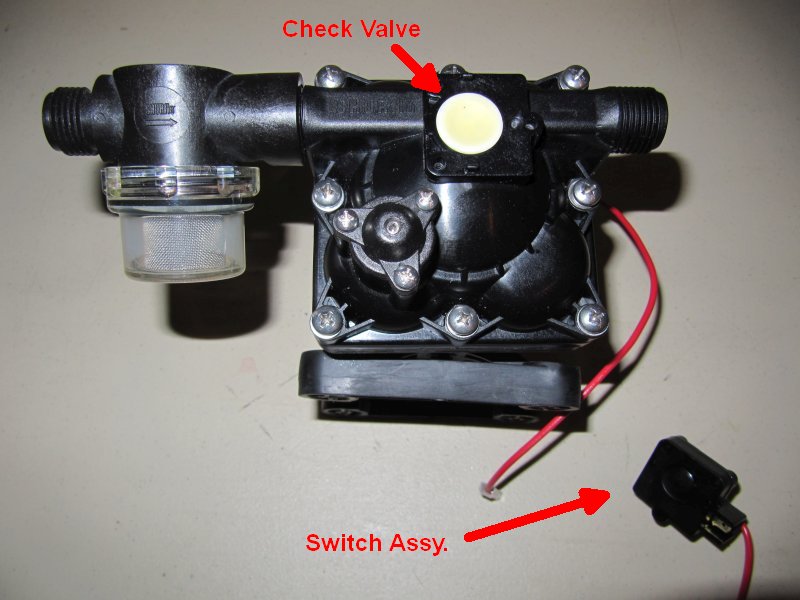

This isn't so much a mod but a repair. I think most Starcrafts have a ShurFlo Model 4008-101-A65 water pump. Last winter in Florida I had a problem with city water flowing backward through my water pump and gradually overfilling the fresh water tank. It wasn't a gusher. I would estimate maybe a gallon per hour was getting through the turned off pump.
I was pretty sure the check valve built into the ShurFlo pump had some sort of debris stuck under the valve. The trailer is only a year old, so I didn't see how the pump could be worn out.
As a temporary solution, I just closed the water valve in the line between the intake side of the pump and the fresh water tank. This is the valve you close when winterizing the water system.
This week I finally got around to removing the pump and taking it apart. The check valve is located under the switch. There is a set screw in the switch assembly and also one in the valve to the lower right. These are for setting what pressure turns the pump on and off. I wouldn't adjust them without a good reason and a good pressure gauge. Switch removed exposing check valve. Check valve parts. ShurFlo sells a check valve rebuild kit part # 94-800-03 for about $12. But the o-ring on the right side of the photo is about the only thing that could cause this issue. I would think a person could get one at a hardware store. I just cleaned my parts, even though I didn't see any evidence of dirt or buildup. We did have a lot of calcium in the water where we stayed last winter.
In any case, cleaning it did the trick. No more backflow.
