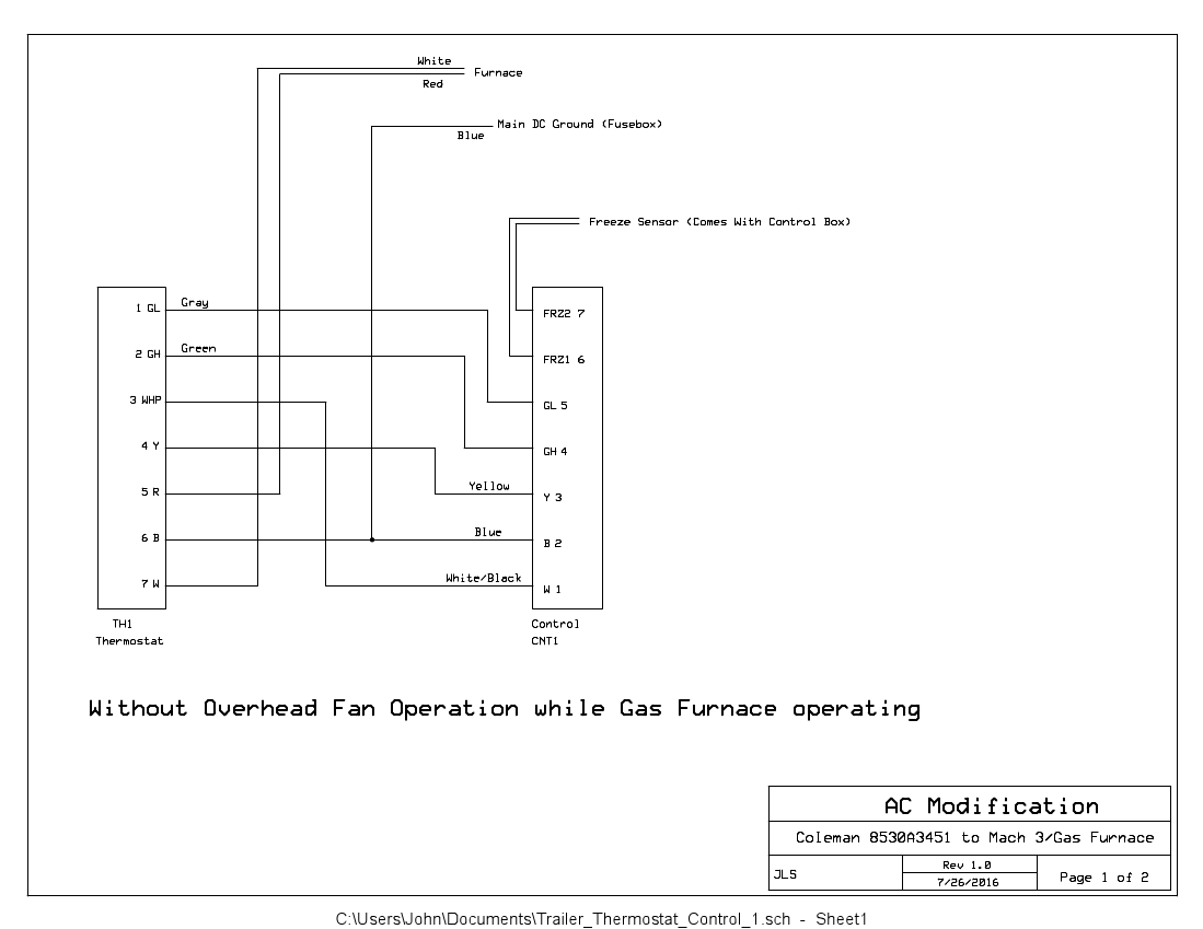

12VDC Heat Pump Thermostat to control Coleman Mach 3 AC and Gas Furnace

Cable will need to be run between Existing Thermostat and AC system. Blue wire will need to be run from either the Thermostat to the power center or from the AC unit to the power center. This blue wire will be used to unify the 12VDC ground throughout the system.
Remove cover from AC unit. Remove knobs from AC Unit cover and remove wiring. Connect wires in accordance with the control board instructions and attached schematic. Install the heat element and control board inside of the Mach 3 AC Unit.
Remove Existing Furnace Thermostat connect new thermostat wires to cable wires and Mount New Thermostat.
Connect blue wire to 12VDC ground in power center and put everything back together.
Documenting this mod will take some time .... I will provide pictures as we move through the nuts and bolts. Attached here is the schematic in picture form.
