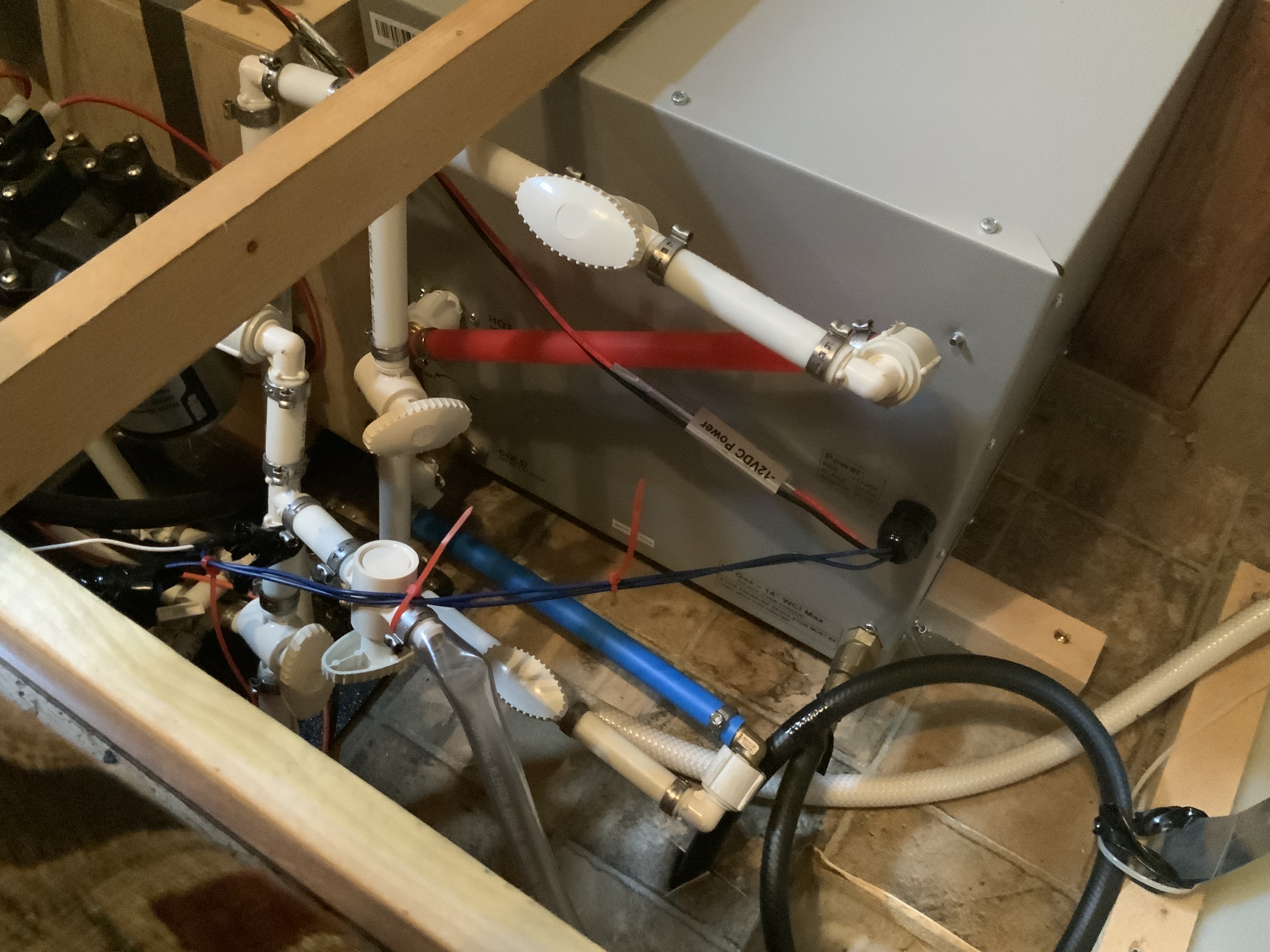

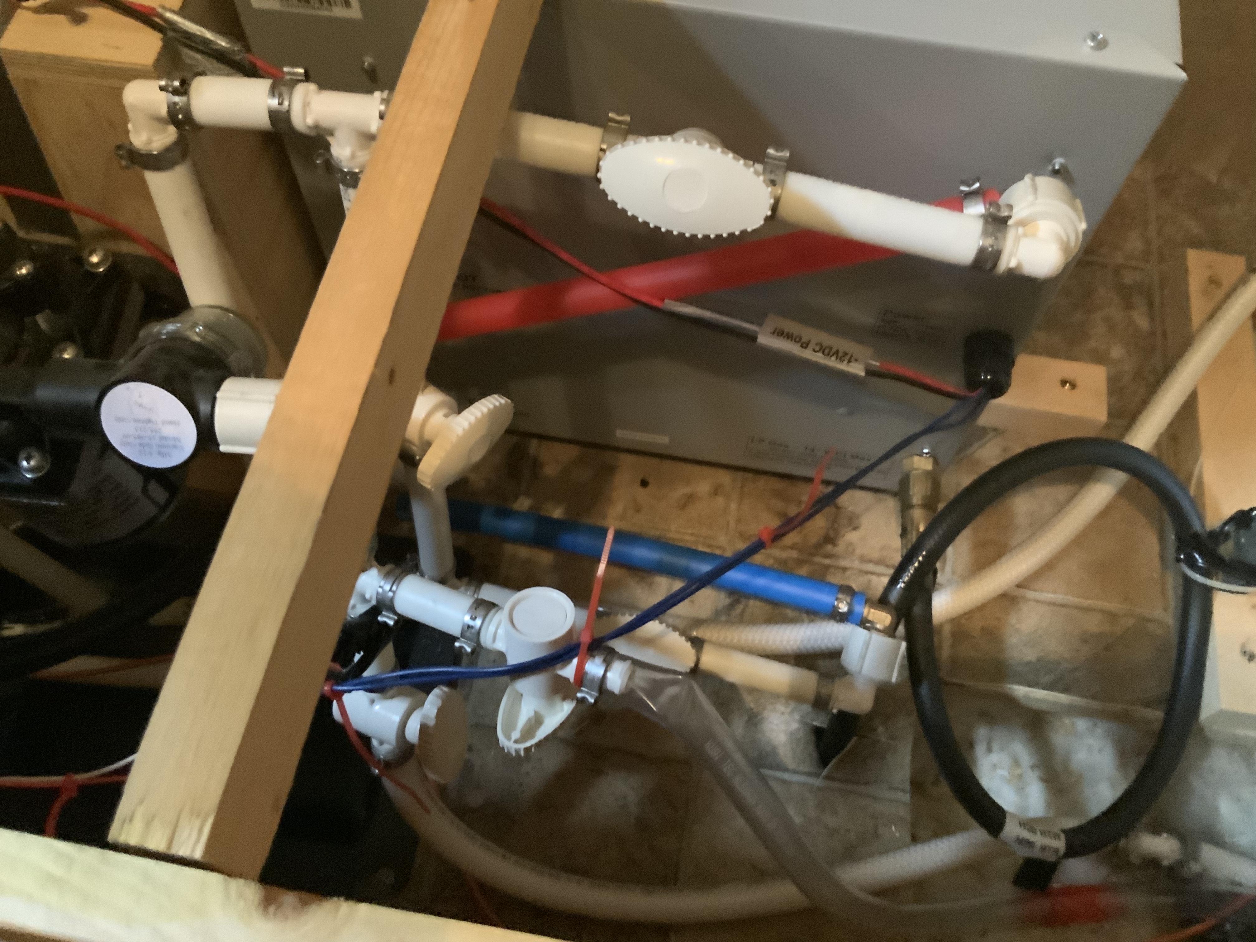

Here are a couple more pics of the water heater. If you are considering installing the Girard in your AR One and have any questions or need help feel free to contact me.
Dscan
Dscan
- Tapped into existing 12 volt wiring from CO detector to power the water heater.
- 2A7B59CA-1477-45C3-923D-54A66B67DE86.jpeg (3.41 MiB) Viewed 9181 times
- Used Pex plumbing to connect heater to existing water supply lines.
- 10CF1C6E-68AE-43A1-B94B-F6A8DF60C6CC.jpeg (3.42 MiB) Viewed 9181 times

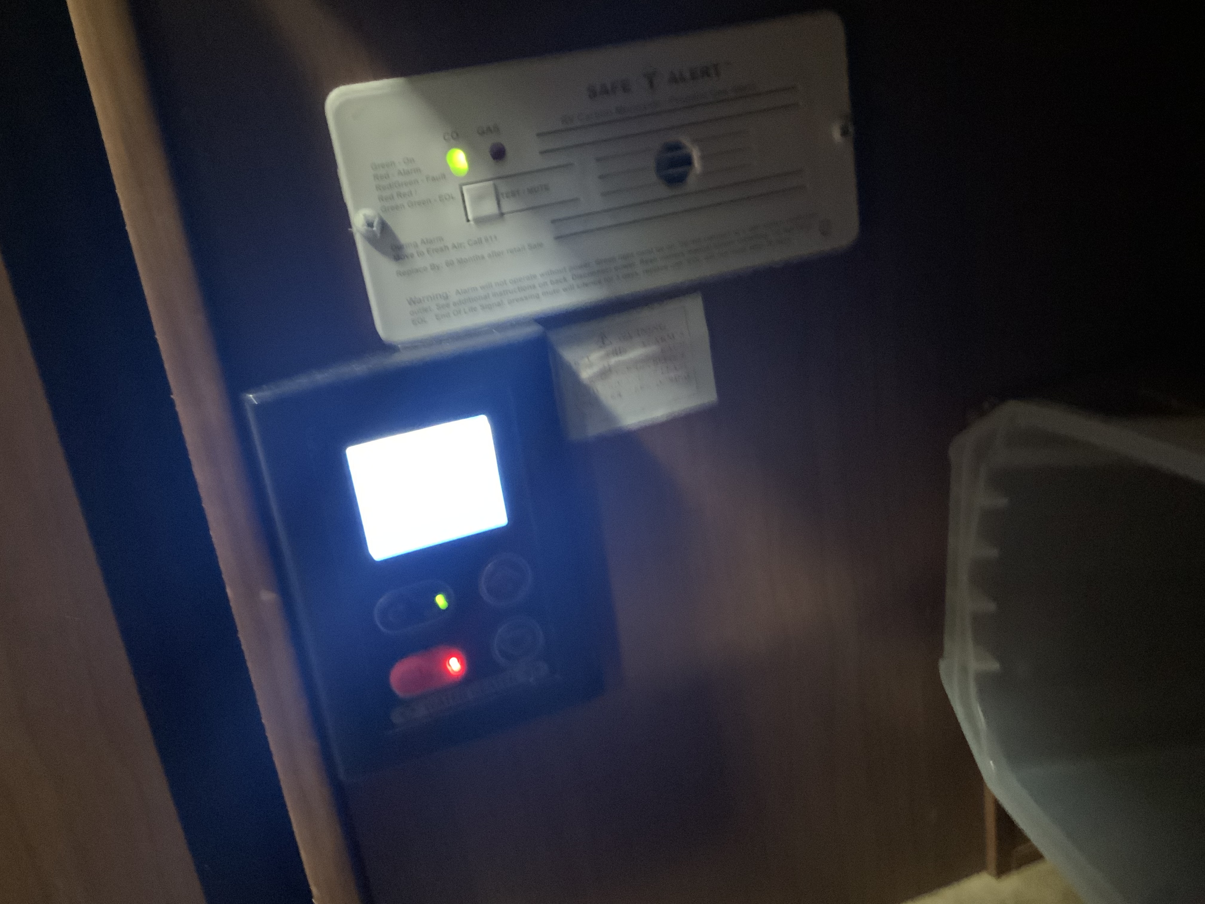

- Mounted included thermostat just under the CO detector for ease of use adjustments to water temp.
- 4D8241B6-7FA2-4514-8239-0FDE619A836A.jpeg (2.93 MiB) Viewed 9181 times

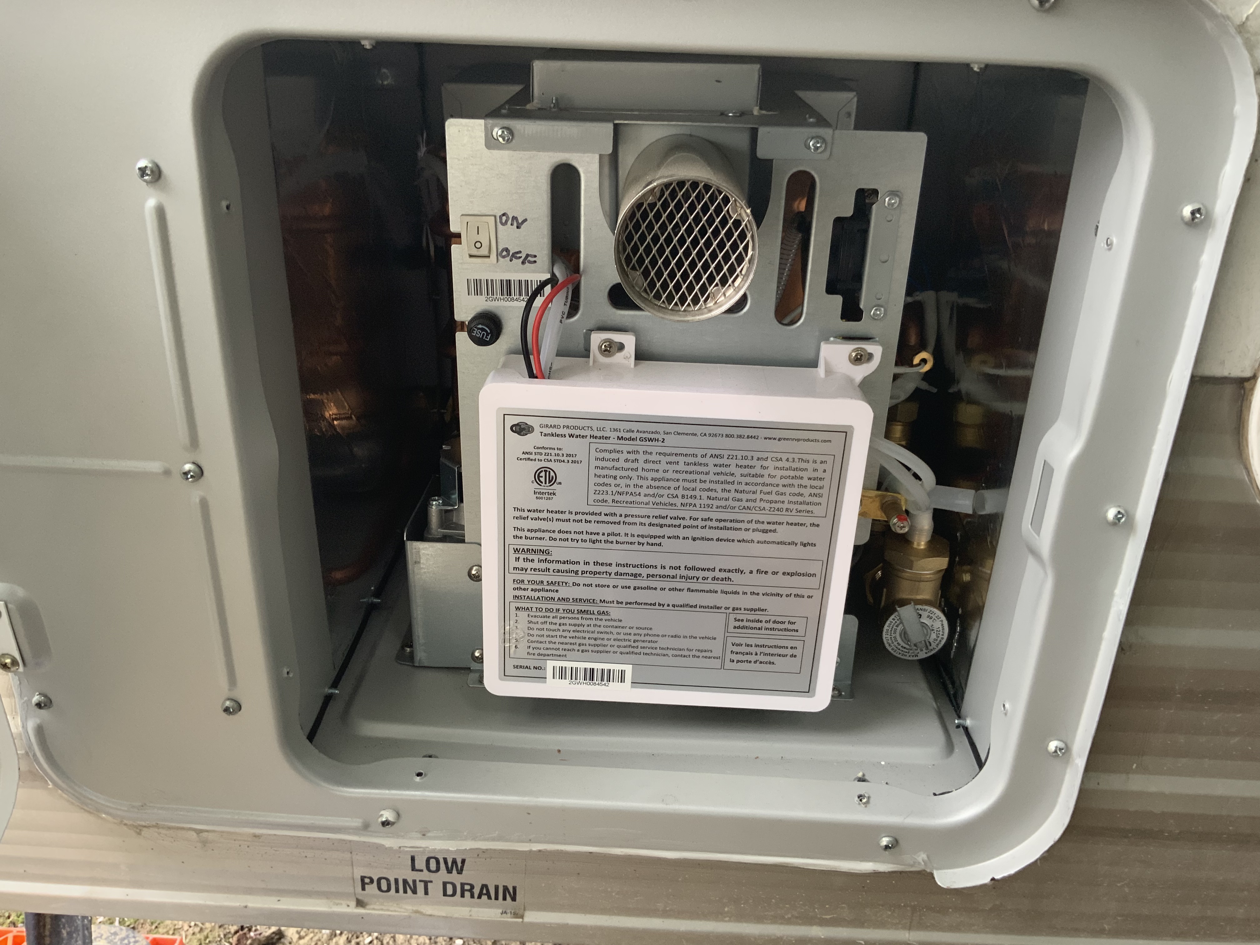

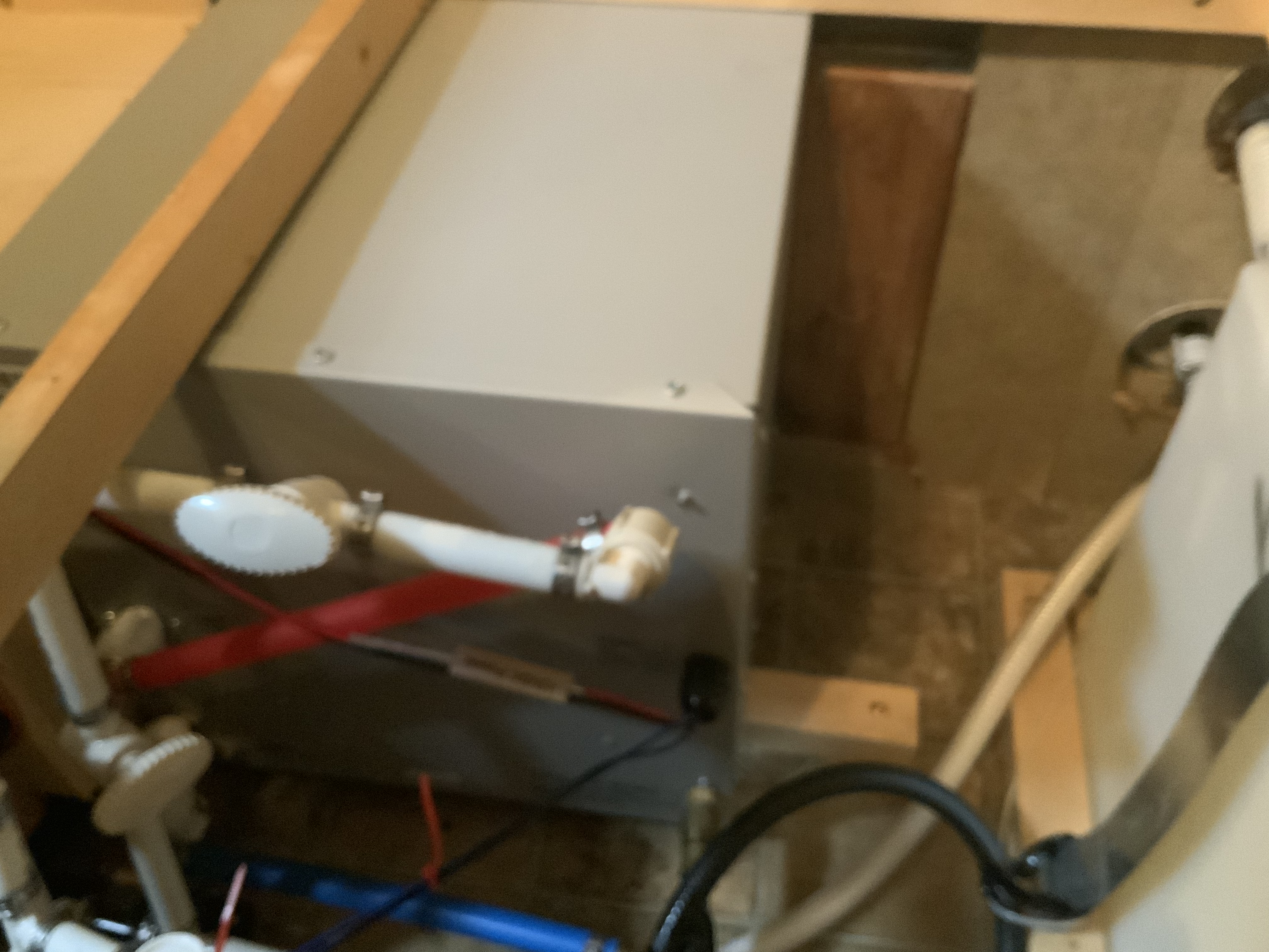

About six months ago my wife and I decided we were going to completely remodel both our home bathrooms leaving us without toilets/showers for about 4 weeks. The plan was to use our trailer which is stored on our property. There was no way I was going to put up with the current water heater everyday for 4 weeks let alone risk running out of hot water during our showers before work or have to wait significant recovery time between showers. So I started looking into upgrading the water heater. Of course I could have just got a new 6 gallon replacement with electronic pilot or get a tankless one. While a 6 gallon one might solve the ease of use and reliability issue it wasn’t going to solve running out of hot water or recoup time between showers. So I went with a Girard GSWH-2 Tankless Water Heater. It was pricey to say the least but not as much as moving the trailer to a park near our home with showers or staying in a hotel for a month. I went with the Girard mainly because I knew it would fit in the space the old heater occupied with only minor mods to the trailer. It looked to be a relatively easy install and turned out it was. Best mod I ever made regarding the trailer by far. Works great and we have had no issues since installing it. Our showers while at home are only limited by the 15 gallon grey water tank capacity but still gives us long enough showers so we don’t feel rushed and the recovery time is only due to the emptying of the holding tank. Since our trailer is not near a sewer clean out we have to empty into a portable tote. We have subsequently used it on camping trips. Since we camped at sites with full hookups we have virtually endless hot showers with no recovery time in between. What a pleasant convenience. Here are some after pics. Didn’t think to take pics while installing it.

- Look from under bench inside the trailer.
- 6688F8EE-47E2-4508-B20C-9AEFDEE2B089.jpeg (3.27 MiB) Viewed 9185 times
- Look from outside.
- 827580A2-55E6-4100-BA07-347E3EE04336.jpeg (2.85 MiB) Viewed 9185 times
- Make sure to pick the correct door to match your opening. Extra cost of course.
- F8F81FC1-8F4C-4C4C-A347-956AC99AE199.jpeg (2.27 MiB) Viewed 9185 times
