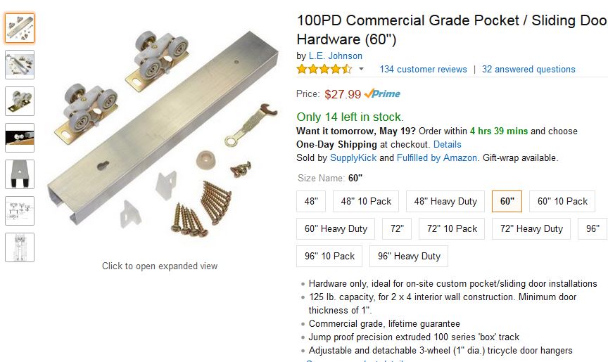

Mine has a full wall between the bedroom and the rest of the trailer with a curtained door opening (about 24" wide). I was looking at installing a sliding door (1" thk hollow core luann covered) from Lowes using this track setup. I'll mount to roof truss. With trim material (lumber I have laying around) and stain, my cost should be around $60. I'll post pics when I finally fab and install it.

Has anyone replaced the bedroom curtain with a pocket door or door of any kind?
