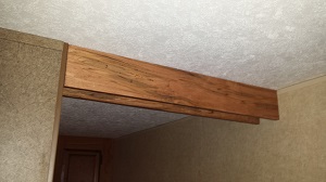

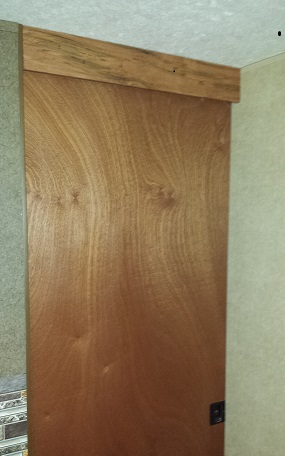

I finally got around to posting pics of my bedroom curtain door replacement. I used a simple eye hook mounted on the end of the door and to the wall to keep stable during transport. The door does not latch (I didn't want to cut into the exterior wall).
- Bedroom side view
- 20170315_202048.jpg (23.11 KiB) Viewed 10358 times
- Kitchen side view
- 20170315_202220.jpg (24.72 KiB) Viewed 10358 times
- Kitchen side view
- 20170315_202252.jpg (62.59 KiB) Viewed 10358 times

If you don't duct tape is wonderful.oldenuftoknowbetter wrote:There will be a gap at the bottom of about an inch from the floor. The opening is right at 25" wide. The door I will be installing is 28". I'll install a "U" shaped guide at the base of the door near the frame to keep it from swinging. I might have to fabricate that if I can't find something that will work. My biggest concern is making sure I hit the bottom of the roof truss when I screw it into the ceiling.jcarlilesiu wrote:I can't wait to see the pictures.
How will you secure it so that it isn't sliding back and forth banging during transit?
