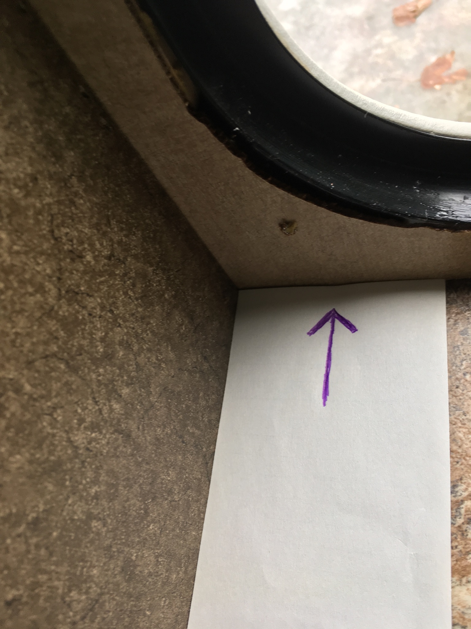

I purchased the trailer used last fall, came with a 30 warranty. Only used it twice, noticed the leak after the 30 days. It’s a 2015 26BHS. The leak is under the front bedroom bed on the left side under the storage door frame. Water is seeping in where the wall and floor meet. I will try and attach a pic. Any ideas?

Check the seal between the armor-plate and front wall/side wall corner. I understand that the previous owner of my RV (2015 26bhs) had a problem the first month he had it so he decided to return the unit. The dealer had to take the whole thing apart and redo it "properly". According to my dealer, it was quite a job. I have had no problem in the past two years I have owned it and we live in the rainy Pacific Northwest. I would get in touch with StarCraft to see what they have to say about this.

I believe I have the same model. Mine is a 2016 so I don't know what year your's is. I'm trying to imagine just where your leak is? Is the water coming down the wall onto the floor on the inside of the trailer in the front bedroom? You might check the window seal or roof gutter. A picture would really help.
